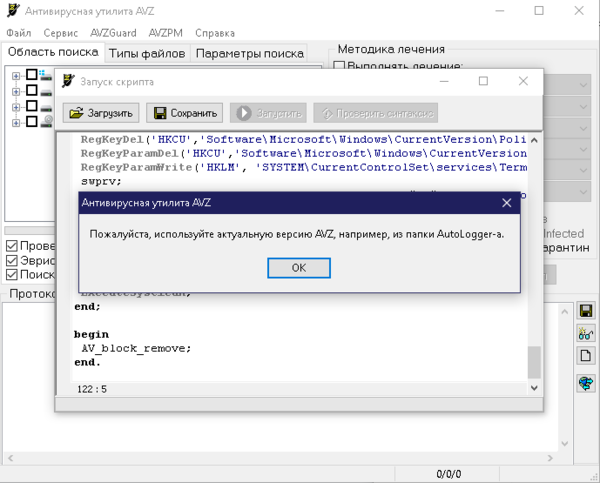

26 минут назад, regist сказал:
var ProgramData, ProgramFiles, ProgramFiles86, fname, OSVer: string; PD_folders, PF_folders, O_folders : TStringList; procedure FillList; begin PD_folders := TStringList.Create; PD_folders.Add('360TotalSecurity'); PD_folders.Add('360safe'); PD_folders.Add('AVAST Software'); PD_folders.Add('Avg'); PD_folders.Add('Avira'); PD_folders.Add('ESET'); PD_folders.Add('Indus'); PD_folders.Add('Kaspersky Lab Setup Files'); PD_folders.Add('Kaspersky Lab'); PD_folders.Add('MB3Install'); PD_folders.Add('Malwarebytes'); PD_folders.Add('McAfee'); PD_folders.Add('Norton'); PD_folders.Add('grizzly'); PD_folders.Add('RealtekHD'); PD_folders.Add('RunDLL'); PD_folders.Add('Setup'); PD_folders.Add('System32'); PD_folders.Add('Windows'); PD_folders.Add('WindowsTask'); PD_folders.Add('install'); PD_folders.Add('bebca3bc90'); PF_folders := TStringList.Create; PF_folders.Add('360'); PF_folders.Add('AVAST Software'); PF_folders.Add('AVG'); PF_folders.Add('ByteFence'); PF_folders.Add('COMODO'); PF_folders.Add('Cezurity'); PF_folders.Add('Common Files\McAfee'); PF_folders.Add('ESET'); PF_folders.Add('Enigma Software Group'); PF_folders.Add('GRIZZLY Antivirus'); PF_folders.Add('Kaspersky Lab'); PF_folders.Add('Malwarebytes'); PF_folders.Add('Microsoft JDX'); PF_folders.Add('Panda Security'); PF_folders.Add('SpyHunter'); PF_folders.Add('RDP Wrapper'); O_folders := TStringList.Create; O_folders.Add(NormalDir('%SYSTEMDRIVE%'+'\AdwCleaner')); O_folders.Add(NormalDir('%SYSTEMDRIVE%'+'\KVRT_Data')); O_folders.Add(NormalDir('%SYSTEMDRIVE%'+'\Config.Msi')); O_folders.Add(NormalDir('%windir%'+'\NetworkDistribution')); O_folders.Add(NormalDir('%windir%'+'\speechstracing')); O_folders.Add(NormalDir('%windir%'+'\Fonts\Mysql')); end; procedure Del_folders(path:string; AFL : TStringList); var i : integer; begin for i := 0 to AFL.Count - 1 do begin fname := NormalDir(path + AFL); if DirectoryExists(fname) then begin FSResetSecurity(fname); QuarantineFileF(fname, '*.exe, *.dll, *.sys, *.bat, *.vbs, *.ps1, *.js*, *.tmp*', true, '', 0, 0); DeleteFileMask(fname, '*', true); DeleteDirectory(fname); end; end; end; procedure swprv; begin ExecuteFile('sc.exe', 'create "swprv" binpath= "%SystemRoot%\System32\svchost.exe -k swprv" type= own start= demand depend= RPCSS', 0, 15000, true); RegKeyParamDel ('HKLM', 'SYSTEM\CurrentControlSet\Services\swprv', 'wow64'); RegKeyStrParamWrite ('HKLM', 'SYSTEM\CurrentControlSet\Services\swprv', 'Description', '@%SystemRoot%\System32\swprv.dll,-102'); RegKeyStrParamWrite ('HKLM', 'SYSTEM\CurrentControlSet\Services\swprv', 'DisplayName', '@%SystemRoot%\System32\swprv.dll,-103'); RegKeyIntParamWrite ('HKLM', 'SYSTEM\CurrentControlSet\Services\swprv', 'ServiceSidType', '1'); RegKeyParamWrite('HKLM', 'SYSTEM\CurrentControlSet\Services\swprv\Parameters', 'ServiceDll', 'REG_EXPAND_SZ', '%Systemroot%\System32\swprv.dll'); OSVer := RegKeyStrParamRead('HKLM','SOFTWARE\Microsoft\Windows NT\CurrentVersion','CurrentVersion'); if OSVer > '6.1' then RegKeyIntParamWrite ('HKLM', 'SYSTEM\CurrentControlSet\Services\swprv\Parameters', 'ServiceDllUnloadOnStop', '1');; ExecuteFile('sc.exe', 'privs "swprv" SeBackupPrivilege/SeChangeNotifyPrivilege/SeCreateGlobalPrivilege/SeCreatePermanentPrivilege/SeImpersonatePrivilege/SeManageVolumePrivilege/SeRestorePrivilege/SeIncreaseBasePriorityPrivilege/SeManageVolumePrivilege/SeRestorePrivilege/SeTcbPrivilege', 0, 15000, true); ExecuteFile('net.exe', 'start "swprv"', 0, 15000, true); end; procedure AV_block_remove; begin clearlog; if GetAVZVersion < 5.18 then begin ShowMessage('Пожалуйста, используйте актуальную версию AVZ, например, из папки AutoLogger-а.'); AddToLog('Текущая версия - '+FormatFloat('#0.00', GetAVZVersion)); exitAVZ; end; FillList; ProgramData := GetEnvironmentVariable('ProgramData'); ProgramFiles := NormalDir('%PF%'); ProgramFiles86 := NormalDir('%PF% (x86)'); Del_folders(ProgramData +'\', PD_folders); Del_folders(ProgramFiles, PF_folders); Del_folders(ProgramFiles86, PF_folders); Del_folders('', O_folders); if FileExists (ProgramData + 'RDPWinst.exe') then DeleteFile(ProgramData + 'RDPWinst.exe'); if FileExists ('%windir%'+'\WrpYGF74DrEm.ini') then DeleteFile('%windir%'+'\WrpYGF74DrEm.ini'); ExpRegKey('HKCU','Software\Microsoft\Windows\CurrentVersion\Policies\Explorer\DisallowRun','DisallowRun_backup.reg'); RegKeyDel('HKCU','Software\Microsoft\Windows\CurrentVersion\Policies\Explorer\DisallowRun'); RegKeyParamDel('HKCU','Software\Microsoft\Windows\CurrentVersion\Policies\Explorer','DisallowRun'); RegKeyParamWrite('HKLM', 'SYSTEM\CurrentControlSet\services\TermService\Parameters', 'ServiceDll', 'REG_EXPAND_SZ', '%SystemRoot%\System32\termsrv.dll'); swprv; if MessageDLG('Удалить пользователя "John" ?'+ #13#10 + 'Если пользователь с таким именем вам не знаком, то нажмите "Да".', mtConfirmation, mbYes+mbNo, 0) = 6 then ExecuteFile('net.exe', 'user john /delete', 0, 15000, true); SaveLog(GetAVZDirectory +'AV_block_remove.log'); PD_folders.Free; PF_folders.Free; O_folders.Free; ExecuteWizard('SCU', 3, 3, true); ExecuteSysClean; end; begin AV_block_remove; end.
image.thumb.png.0adbe4afb4e377c1a3fd4094febcdf4d.pngпуть программы D:\Users\USER\Desktop\Новая папка (4)\AutoLogger\AVZ avz.exe

      Здравствуйте, проблема такая, после удаления майнера и процедуры лечения всё вернулось в норму, но перестала обновляться Windows
      Так же были проблемы с запуском некоторых команд в командной строке, но их исправил путём удаления из реестра
      Фото ошибки прилагаю
