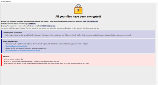

На компьютере появился шифровальщик.
Файлы на компьютере приобрели расширение ncov
На экране появляется сообщение
All your files have been encrypted!
All your files have been encrypted due to a security problem with your PC. If you want to restore them, write us to the e-mail 3441546223@qq.com
Write this ID in the title of your message 4E44B38D
In case of no answer in 24 hours write us to theese e-mails:3441546223@qq.com
You have to pay for decryption in Bitcoins. The price depends on how fast you write to us. After payment we will send you the decryption tool that will decrypt all your files.
Free decryption as guarantee
  • Before paying you can send us up to 1 file for free decryption. The total size of files must be less than 1Mb (non archived), and files should not contain valuable information. (databases,backups, large excel sheets, etc.)
How to obtain Bitcoins
Attention!
  • Do not rename encrypted files.
  • Do not try to decrypt your data using third party software, it may cause permanent data loss.
  • Decryption of your files with the help of third parties may cause increased price (they add their fee to our) or you can become a victim of a scam.
