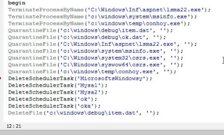

Закройте все программы, временно выгрузите антивирус, файрволл и прочее защитное ПО. Отключите на время лечения сервер от локальной сети.
begin
 TerminateProcessByName('C:\Windows\Inf\aspnet\lsma22.exe');
 TerminateProcessByName('c:\windows\system\msinfo.exe');
 TerminateProcessByName('c:\windows\temp\conhoy.exe');
 QuarantineFile('c:\windows\debug\item.dat', '');
 QuarantineFile('c:\windows\debug\ok.dat', '');
 QuarantineFile('C:\Windows\Inf\aspnet\lsma22.exe', '');
 QuarantineFile('c:\windows\system\msinfo.exe', '');
 QuarantineFile('C:\Windows\system32\csrs.exe', '');
 QuarantineFile('C:\Windows\syswow64\csrs.exe', '');
 QuarantineFile('c:\windows\temp\conhoy.exe', '');
 DeleteSchedulerTask('MicrosoftsWindowsy');
 DeleteSchedulerTask('Mysa1');
 DeleteSchedulerTask('Mysa2');
 DeleteSchedulerTask('ok');
 DeleteSchedulerTask('oka');
 DeleteFile('c:\windows\debug\item.dat', '');
 DeleteFile('c:\windows\debug\item.dat', '64');
 DeleteFile('c:\windows\debug\ok.dat', '64');
 DeleteFile('C:\Windows\Inf\aspnet\lsma22.exe', '32');
 DeleteFile('c:\windows\inf\aspnet\lsma22.exe', '64');
 DeleteFile('c:\windows\system\msinfo.exe', '32');
 DeleteFile('C:\Windows\system32\csrs.exe', '');
 DeleteFile('C:\Windows\syswow64\csrs.exe', '');
 DeleteFile('c:\windows\temp\conhoy.exe', '');
 DeleteFile('c:\windows\temp\conhoy.exe', '64');
ExecuteSysClean;
 ExecuteRepair(9);
end.
