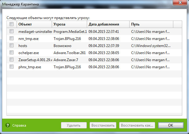

Ответ c Каcперcкого:
1405.tmp - Trojan.Win32.Fsysna.brrs[/size]
cppredistx86.exe - Trojan-Downloader.Win32.Delf.bbmt[/size]
ssleas.exe - Trojan.Win32.Kesels.a[/size]
temp2847910848.exe,[/size]
temp2847910848_0.exe - Backdoor.Win32.Hlux.entq[/size]
